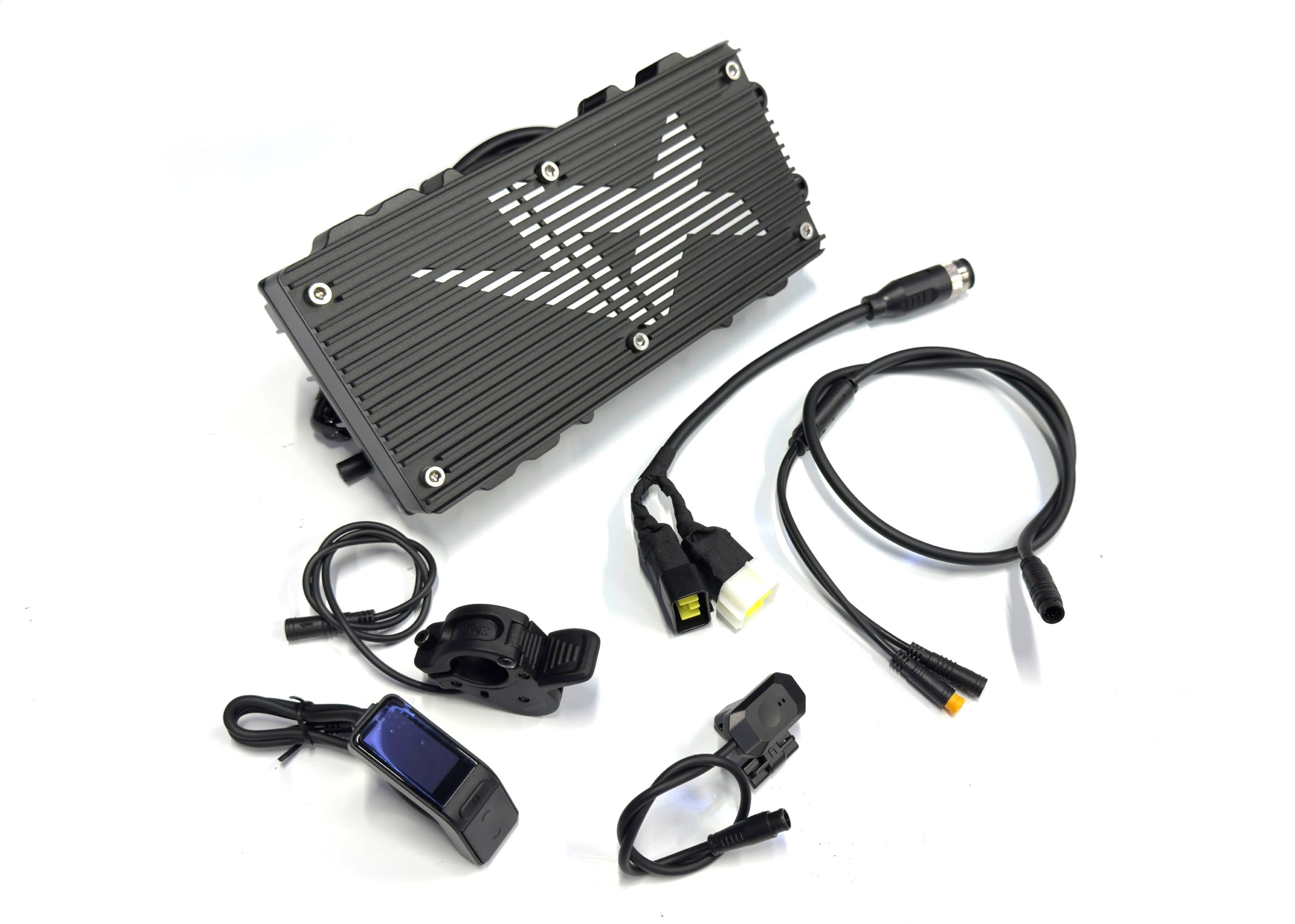

I got my X-9000 V2 from Gritshift. The V2 will not work with 96V because it wouldn't work with my 84V battery. EBMX said there wasn't enough headroom for the V2. 81V nominal is all the V2 can handle. Suposedly the V3 can operate up to 120V so I would think it can handle 118V the voltage when the 96V is fully charged.

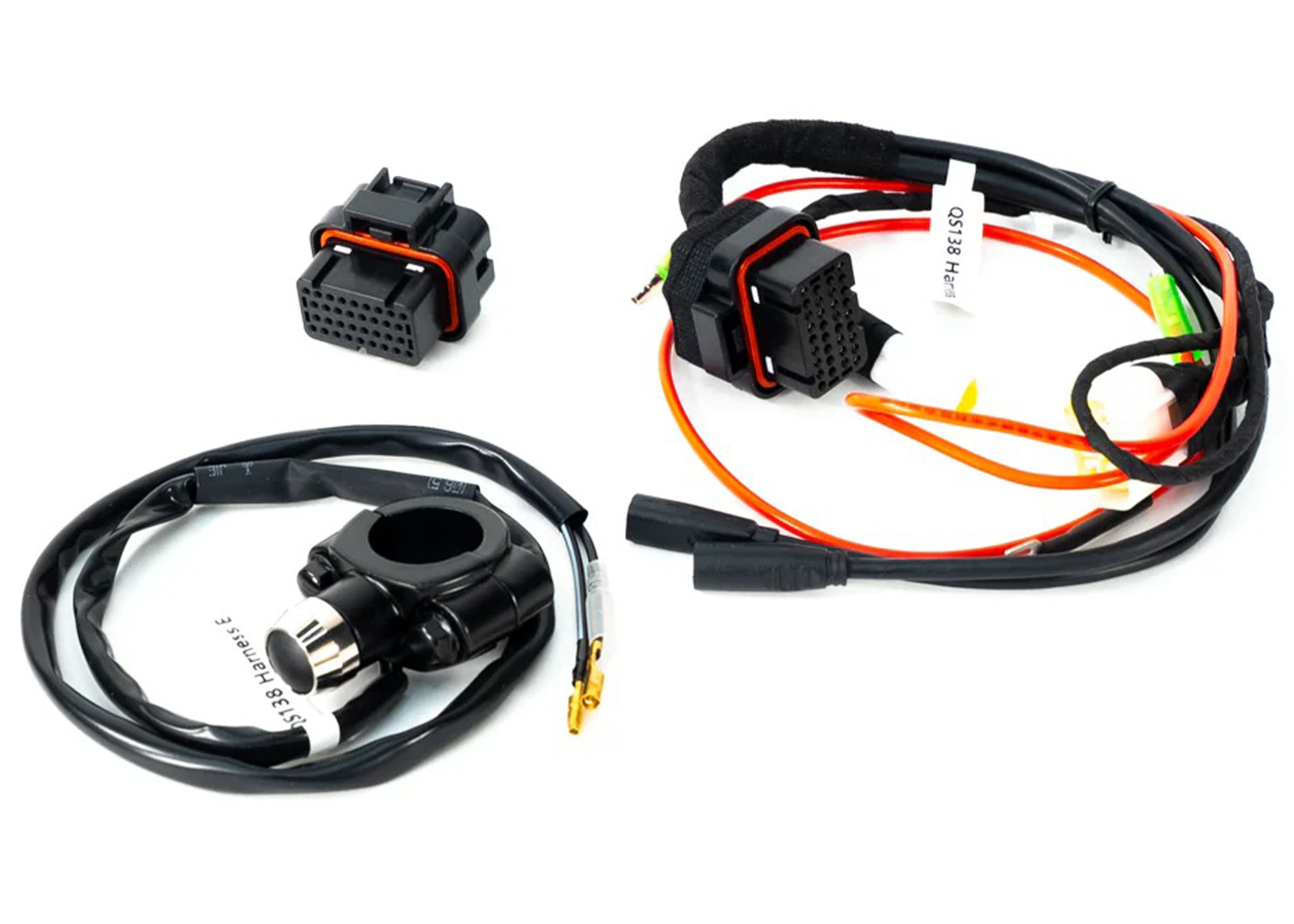

I will msg EBMX to doublecheck. I don't know if they have V3 QS138 harness yet also

Gritshift is in Florida so they might be closed right now. I don't see the V3 harness. The V2 and V3 are not compatible.

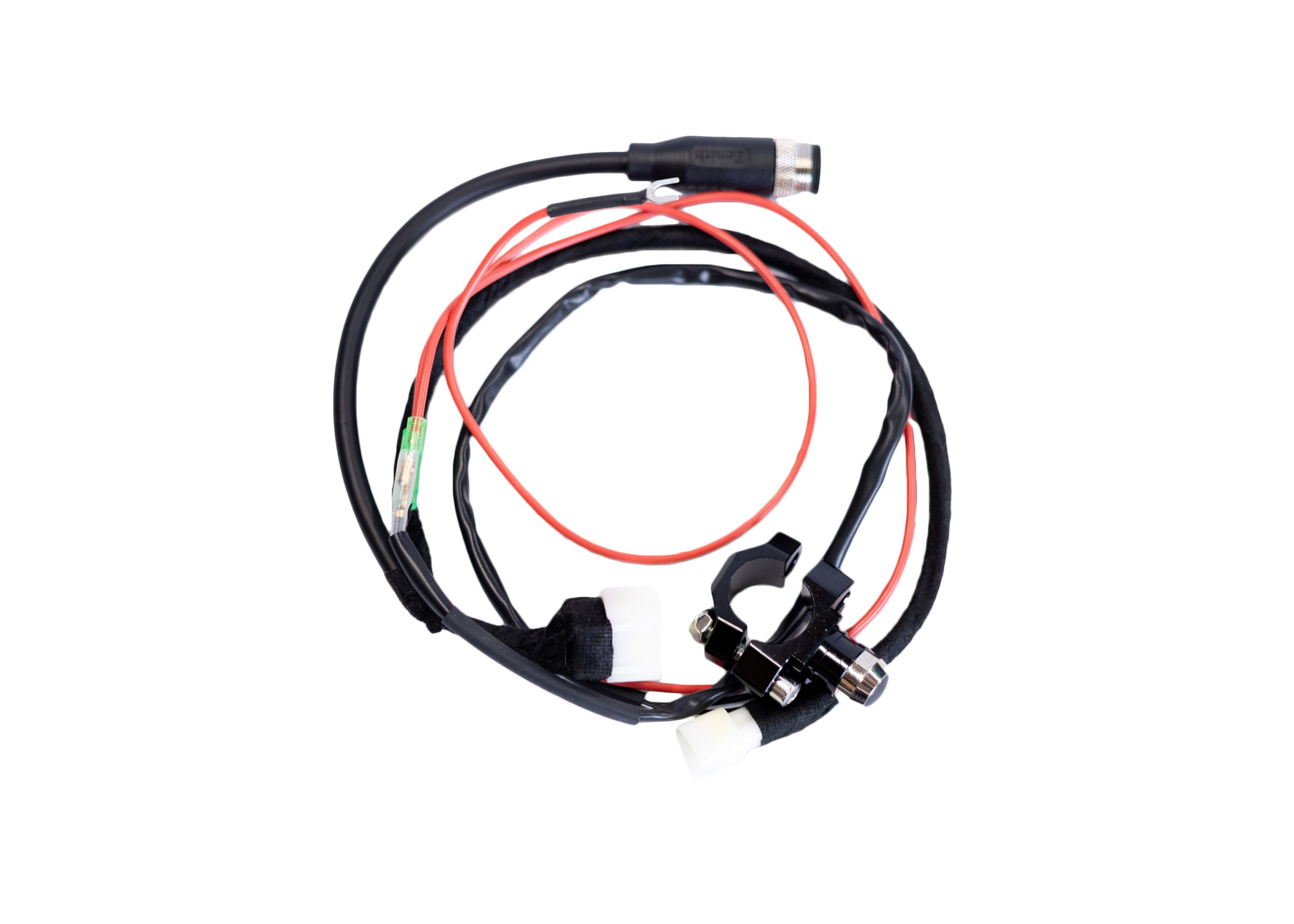

What I did is buy the Light Bee kit and then the QS race harness. But remember the V2 ism"t compatible with the V3.
