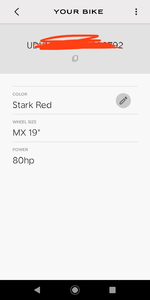

I think im too stupid to find the firmware version of the bike (not app version).. :( can anybody share a screenshot where in the app it is displayed ?

On the Stark phone, in the Stark app, check your bike's firmware version by tapping on the gear (settings), then tap on "Your bike."

Yeah i know where.. but it seems to be missing. Thats why i wanted a screenshot to compare :)

Yeah mine looks like yours and doesn't show the firmware version I believe. Also mine has a yellow flashing light but will not update. I still have to schedule a support call but I've just been too busy to do it. They were ultra responsive but I just can't take the time Until next week. It still runs fine in the meantime.
