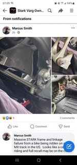

:( Flat landed of a big jump I believe.
This is where the Varg being all electric really pays off. Just order the optional welding cables from Stark, along with the welding app for the phone, and you can use the juice from the bike’s own battery to weld up that broken frame right at the track! (Welding helmet and bottle of Argon sold separately.)
Heck, after only a few YouTube tutorials, you too could make a little side money and pay for the electricity you need to charge your bike by simply setting up camp within crawling distance of the gnarliest jump on the track. Just offer your metal mending services to the poor unfortunates whose ego outstrips their riding prowess on Dead Man’s Leap or Fifth Gear Pinned Gulch.
You can make additional side-money by investing in other popular Stark electronic add-ons, such as the Stark tire inflator, the Stark pressure washer, and the very popular Stark margarita maker (a.k.a. the Vargarita Machine).
The reality is it’s not really broken….that’s just the angle the picture was taken from. It’s propaganda.
But I’d get the welding kit in case those ICE bikes need some help trackside….cause that’s how I roll.

So far stark has sent me a ton of little odds and ends parts free which I probably did not really need. Overall they paid my tab for a Dunlop tire, plus sent me a brand new OEM setup rear wheel. I believe with these business ethics stark will cover their defects. And the above post where Marcus blew out his linkage from the frame, I kid you not… he probably got a brand new bike. I remember seeing this image somewhere before and I thought I heard Stark wanted to retrieve that bike back to Spain. So my guess Stark hooked him up good.
