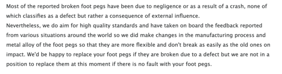

erSitzt
42
hmm my phone did not upload the images on my post.. so second try here
Today while normal riding on a sand track..
No rocks, no crash, no jumps cased.
In february i asked support if there is an issue and if they will replace footpegs even if they have not failed yet..
This was the Answer
I'm not sure what "negligence" is supposed to mean,,,

You certainly qualify for new pegs. I assume you had the original “breaky” ones.
