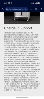

Let's even say that he discharges the battery at 80 % (I don't know at which percentage a 6.6 kw charge would start to be reduced when getting close to 100%), consider that the charger is rated at 3.3 kw in the specification sheet downloadable at Stark's site, so he could even theoretically use an adapter and connect that charger to a charging station but he would't get more than that. After all, they would never allow a Shucko plug to pass more than 3.5 kw and I believe that it already gets 3.5 kw and roughly 0.2 kw are lost in inefficiency.

yeah thats the new portable charger of 3.3, but should be another big one for "home charging" of 6.6kw, thats what the CEO said... no info yet but the APP is now showing the 6.6 option thats why im confused
Surely that would "home charging" only if you already have your own EV charger setup at home, right?

What I mean is that Stark is supposedly going to release a charger identical to the one that comes with the bike but with 6.6kWh. I'm not an expert so I don't know if it's possible to plug a 6.6kW charger into a conventional wall socket or if an installation for that power is needed.

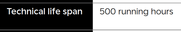

That said, their promise for the Varg EX in the manual is pretty low:
That's five hours riding per week over two years; or a depreciation of €28 per riding hour for a basic Alpha.
Bodo

Aye, that's my point, Erwin. There's no reason to choose battery charge/discharge parameters to make it last longer than 500h, except to avoid warranty claims.
6.6kW charging is roughly 1C; P50B cell maximum is 5C -> 6.6kW is well within lifetime expectation while maintaining it safe against warranty claims. I imagine 2C could even be possible.
that number concern me a lot, i already have 160 hours on just 5 months of use, and the limit is 500 hours? so the bike wont last me even a 2 year lifespan at this rate? and i dont even use It that much, some trails every other weekend and 2 days a week for work... i cant believe that
403
The bikes expected life where the bike functions as it should at the expected use is 500 hours.
Same for the MX.
That 500 hours is competition use. Jumping, bashing, racing. The stress to the frame and everything around it in MX or Enduro competition is something completely different to what you are doing.
You will see claims like this at any bike, especially MX and ENduro bikes.

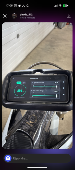

A friend of mine, actually charged at 6.6kW and it's working for him, it's drawing 5.9kW and he charged from 10-85 in like 45 min to an hour View attachment 15087
Very interesting.
Considering 75% of 7.2 kwh, i. e. 5.4 kwh, in in 45/60 minutes, it must be indeed charging at more than 5 kw.
Pretty weird that Stark hasn't sent any email about this update.
I'd like to know whether there are signs of burns on the pins of the Schucko plug, though.
