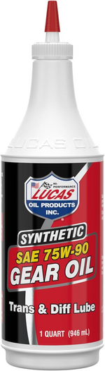

I haven’t got through all 10 pages yet but is any consensus on the best oil to use or where to buy? The only one I saw listed was the Motul brand. Any other recommendations?
274
Thanks for the reply. That definitely readily available. Was of thinking of this, does this meet Starks requirements for the EX?
I would imagine any SAE 75w90 would meet the requirements. There is no clutch or any slipping parts so as long as it meets the SAE you should be good.
Oh BTW as you can tell after draining it uses a very small amount of oil, so a bottle goes a long way. I usually flush a little clean oil through, probably wasteful but I am paranoid.:ricky:
