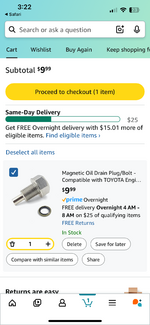

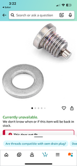

Add me to someone who had issues getting the drain plug out. I tried every torx head I had to make sure it was snug. As soon as I applied torque the flippen head stripped. Tried an impact driver and it just removed all the teeth. I then hit it with a torch and vice grips and it finally snapped loose. It was WAY too tight. By the way the Amazon link (on this thread I think..) to the drain screw with hex head didn’t fit. The head is too big to fit in the space.

I don't think that Toyota plug has the right threads, should be M10 x 1.5 for the Varg.

As you can see from my picture, the head of the toyota plug is way to big to fit between the threaded hole and side cover (see my pic holding the hex head plug up to the varg). The treads look correct to me, it's the size of the hex head that's the problem.
