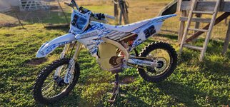

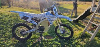

I was asked for information on this build so I thought I would share it with everyone. Let's start with the end Product, a picture (IMG2785) and a video of it at the track yesterday.

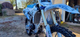

I started with a 2014 YZ450F donor bike (IMG2571). This bike had been modified as another electric motor bike so I removed all the new lower tabs to start fresh. You can make non welded in mounts to do this also, but I elected to do the weld in method. I am only showing the main pictures here, but I have a ton of images of the build.
I use 6061 Aluminum 1/4" x 1 1/2" across the down tubes, and for all the motor mounts, and the battery supports.
I built the mount for the swing arm bolt, ( i will explain that in Part #2) that would be going down to the main frame center, and up to support the back of the battery tray. This battery tray could be built with a quick change battery system if wanted. XEMX1.com will be selling a kit very soon. Ask and I can get you more info .
I mounted the motor, and alignment with the rear sprocket is very important, and hard to get an alignment point. I find a straight edge to come from the rear sprocket is good. ( make sure the rear wheel is true in alignment on the swing arm) and to wear marks on the chain guard on the swing arm. You want also to position the sprocket center to as close to level with the swing arm bolt and as close to the swingarm to allow bigger sprockets to fit. I am using a 520 13T sprocket, and it barely fits on the motor, to were it will hit the nub on the motor, and it already has..., (I have to move it out by 2 washer/spacers, since it is touching/wearing) The motor and it's brackets kind of limit how close you can get to move it back and down, so do your best. You are splitting hairs, if you are close it is good, just make sure the sprockets is true to the rear sprocket.
Next is the Controller mount. You will see a special bracket that mounts to take the weight of seat and mount the controller. I can make you these if anyone wants them. You spread the sub frame outward 1/4" on each side. Very easy. You can see it in IMG1604. Then I make a tray out of 1/8' soft aluminum, so I can bend it to what I want, and open the middle up for a future water cooler if you want to go to 450A ( the controller does heat up at the higher currents). I can supply these brackets and coolers too if you need them.

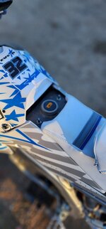

Here is the top of the bike with the meter and the Master ON1,ON2,Both,OFF switch, and the Voltage and Current Meter, IMG2680, and then the underside.( IMG2862) 2 #6 wires from each battery pack and #4 to the controller. I have an Antisurge resistor across either pack lead and output. It is a 1K 10W resistor.

I took it out to Glen Helen Tuesday. It was the first time I rode on the REM track. What a fun track. I got about 10 laps on it and then on the charger. If it wasn't moving it was on the charger. With all of us riding it we did about 30 laps. There were at least 5-6 others that took it for a few laps. What a blast. This youtube is 1/2 a lap, my sighting lap, and the memory chip was full on my GoPro. So no more video. It ran flawlessly all day.
I got to ride a friends brand new KX250 for some laps, and the power wasn't much different, but man you had to shift and clutch, an throttle it...man the electric is so simple drive, twist the throttle and go... And I was in mode 2 most of the day, next time I want to try mode 3 with a full battery.
