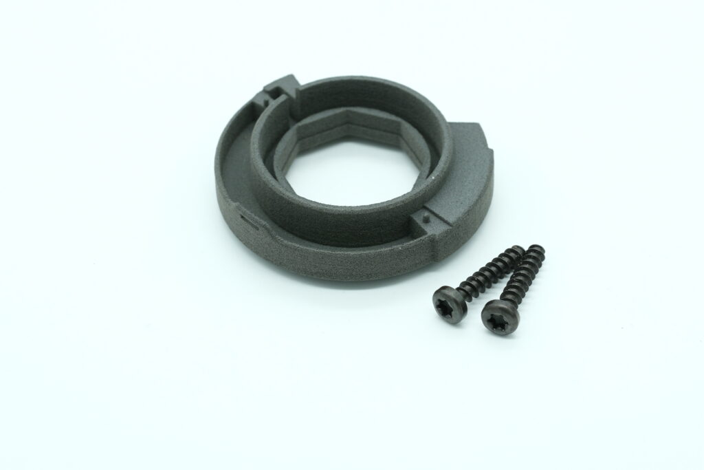

It was one of the first things I did to the Varg as I never rode with the stock grips - got some ODI universal lock ons. The housing screws on the Hirschmann throttle are pretty soft metal which is easy to drill. Instead of drilling out the head of the screws completely I used a 2mm drill bit to make a hole a few mm deep and used some screw extractor to get the bolt out. Basically you should do this to any Varg as this will enable you to remove and clean the throttle tube without unplugging the cables (which is a pain on the EX).What made you open the housing and try it in the first place?
Is there any tool that will undo housing screws without drilling them out?
Yes, the "spring neck" in the picture above is what I was talking about. There is a pocket in the hosing where it seats into, but you can also use the pocket besides this one for less preload. I'll try to make some pictures.
