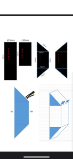

I found a few extra millimeters for more storage. I've changed the size of the battery to give me 20s13p for 72v 58.5Ah. I'm totally stoked! Here is the final battery box size:
585
Dave, I told you that Amorge can make almost any size, but there are some limitations. The width of 6.10" is maybe doable, send it off to Amorge, and they will let you know if the can and will give you a price. Usually they stack 2 rows of cells in that direction, so that is why I think why they got our batteries down to 6.25". Let them tell you.
On the BMS , if you go with open discharge, you want the BMS to handle 40-50A charge. The one they put in the KTM battery was a 220/550A 480A Peak. That has I think 50A charge
Also if you go to Molicel P45B cells, you get a slight improvement in range. These are the cells they are using in the Starks. There are also P50B cells, the give you almost 20% improvement in range, but at the best price I could find, they were almost twice the price per cell ($8.50 per cell in quantity that we need) The P42A cost $4.35 per cell in our quantity, and the P45B are $5.27 per cell.
