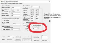

I'm struggling with the oversensitivity of the Surron throttle that came with my E&C kit. I purchased and received an QS e-cable throttle assembly. Are there any tricks to connecting it to my Votol EM 260?
Dave Daum
121
Before you change the throttle, there are settings in the software that lets you soften it up. Adjust this number down from 16 toward 2 , 2 is very soft, 16 is aggressive.
Wow what a difference! I went through several different settings. Balancing the right amounts of engine braking and soft start make the throttle response so much more pleasant. Now I'm able to roll up to slow speed obstacles and gently torque my way over them. Over rolling bumps I can now modulate the throttle so the bike no longer jerks and lunges out of my hands. And, it is so easy to change as conditions change. The bike has become an absolute dream to ride!
